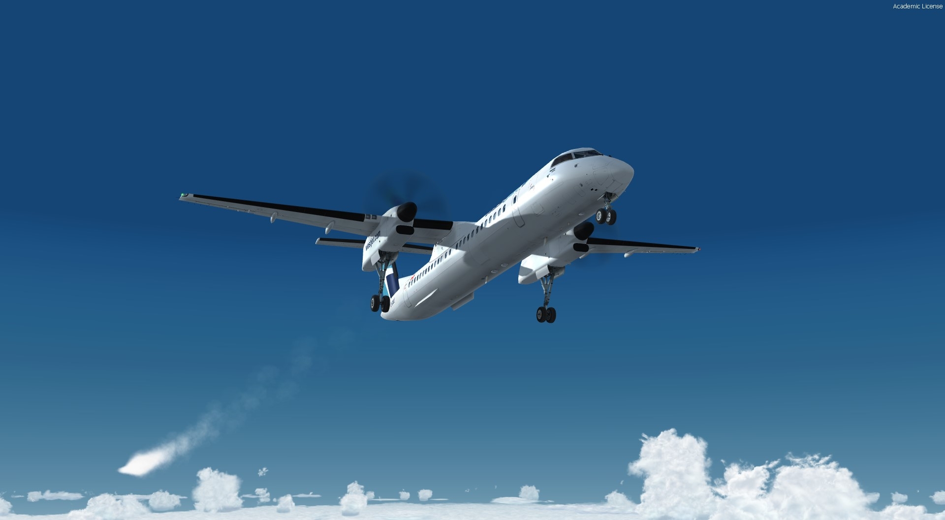

    I've been flying the Dash pretty much constantly over the last few months. Today, the landing gear retract issue is back, with the gear handle, assigned jostick key and default ´G´key having no effect. More interestingly, when i go to the outside view, I only see contrails from the No. 1 engine, nothing from No. 2 - indications in the cockpit are good. I wonder if this might somehow be related? I've only noticed the contrails today due to the OAT. I also wonder if this might be a procedural thing. Today, I was pushed back from that gate and then I applied the parking brake before commencing engine start. Most times I start No.2 during pushback.....

    Thank you for the update. The observation of the contrail is interesting although I doubt it is related (although it could be possible). That effect if I am not mistaken is driven by the Dash 8 immersion, but certainly interesting to see only one engine producing the effect.
    As far as the possibility of being a procedural issue, if it were I suspect that the issue would be easier to replicate, as I too do perform several types of engine starts during the pushback phase. I guess the question could be what could be the commonality between all users who have experienced (myself included) the gear failing to retract event (I have used the Q400 immersion in the past - but having to install and re-install for testing I just don't use it).
    What ever is causing this issue is happening between the pushback and takeoff phase, almost as if the WOW sensor thinks that the aircraft is still on the ground, but also prevents the gear handle from moving as well.
  • hi Kroswynd,
    Just for info, I do not use the Dash 8 immersion, only preciptx and contrails have worked in the past. It just seems coincidental that gear is down and only one contrail. :-) Onwards and upwards.
  • Hi @ScottecLEMD ,
    Thanks for the heads up, it is odd
