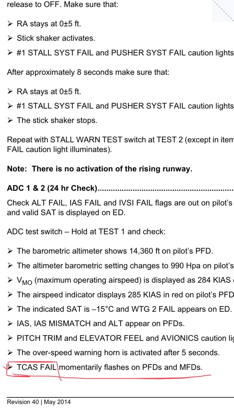

When performing the ADC test, "TCAS FAIL" seems to be displayed in PFD and MFD for a while, but it is not reproduced with this software. Will it be reproduced in future updates and training versions?

What do you think after seeing this? Although it may be an inherent characteristic possessed by Q 400 ...
The picture is a manual of a certain airline company.
Thanks for the share. Our manuals AMM and system manuals do not reflect this. This could very well be a software upgrade or added option which is not a part of the data based on the aircraft we modeled.
The likely hood of it being added to the Training edition at this time is not likely unless we can have all the supporting data linking the TCAS system with the ADC tests.
Well spotted! Maybe a change for the training version.
The TCAS system is not a part of the ADC TEST.
