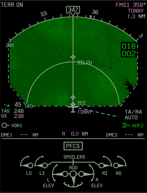

Route on ND is a straight line when it shouldn't be
I've had a couple of flights where the route on the ND did not depict what it really was, i.e. different headings for certain legs, but just as a straight line. For example, a SID that runs 2 NM on runway heading, then 90 degree left turn for 4 NM, then 30 degree right turn - all shown as a straight line. Switching on "DATA" to show Navaids and Airports they all show on that straight line.
Is that a bug? Is there some manipulation that I should not have done?

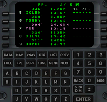

  • Same issue as being described, entire flight from ORD-YTZ (Route Below) where all waypoints were in a straight line including the enroute/STAR/Arrival
    Restarted P3D and checked my Nav Data was up to date, running version 1.026A YTZ-YQT (Route Below) Same issue. It does not appear that the aircraft flies the route incorrectly, its how its being displayed on the ND. Switching between FMS1 or 2 didn't help either. From the snips on the FMS you can see what the heading should be, but the waypoints on the ND seem to be stuck to the nose of the aircraft.
    ORD-YTZ (KORD/22L N0323F250 DCT EBAKE DCT WISMO DCT POSTS DCT PADDE DCT SVM DCT GGUCE DCT KEDBU DCT LINNG DCT CYTZ/26)
    YTZ-YQT (CYTZ/08 N0319F230 DCT IKLEN DCT TONNY DCT YEE/N0320F240 DCT SILVU DCT DUPUL NOTER4 CYQT/25)
