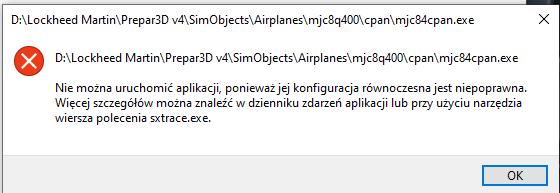

I recently took a break from Dash and when I went back to him and tried to run the Control panel, I was showing this error. I was reinstalling Dash and it didn't help. Please help

    Not sure what the error message is saying as it is not in English.

    Translated text from the photo:
    The application cannot be started because its simultaneous configuration is not correct.
    More details can be found in the Application event log or by using the sxtrace.exe command-line tool

  • I will write it differently, I run P3D v4.5, choose dash and painting. I go to an airport and everything works in the dash, it starts in the standard procedure, PFD and ND are started. When I want to run CPAN to change the settings and enter other things to do the flight, CPAN does not start when I run it by the administrator, the error that I have already sent above pops up. I was reinstalling Dash it did not help. I also did Windows file consistency also did not work I reinstalled all microsoft visual c ++ also did not help even reinstall P3D please help I have no idea what may not work

  • I have already dealt with the problem. The reason was simconnect, I had to install it and everything works. Thank you
