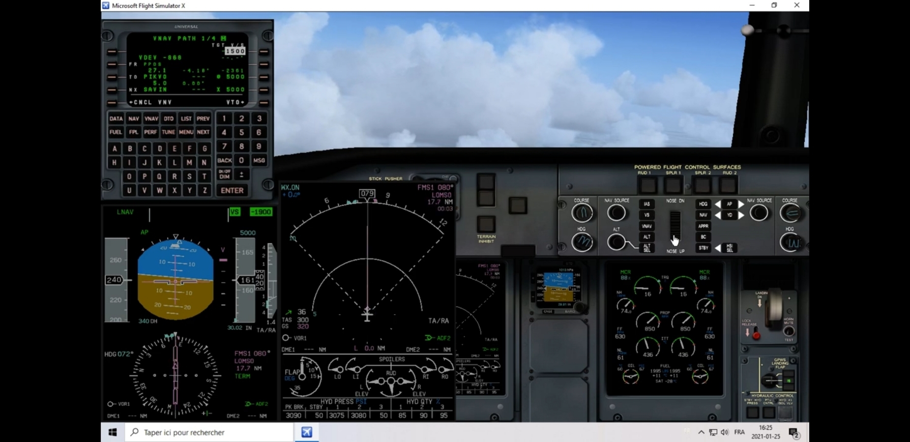

    can you look my video and say me my mistakes and why i get pitch hold.
    CYUL to CYQB star pesac4 runway RNAV 24
  • Because I don't want always to calcul VS to descent to next constraint.
    Unfortunately you have to do a bit of calculations as the computer cannot replace the human brain.
    On your video we can see that you have a GS of about 340 Kt. We know that there are 26 Nm between GONUM and PIKVO and you have to loose 11000 Ft in about 4'30" which would give a VS of nearly 2500 Ft/mn. As explained before, nothing stops you to ask ATC to start your descent before and to aim for PIKVO 5000'.
    On your video 14'17" you were at VS 1400 Ft/mn so when the aircraft computer find that the VS should be about 2100 Ft/mn it would go to PITCH HOLD as it does not understand what's going on.
    When you went to VS you change all the time from 2300 to 1800 and to 2100 which is not good and the passengers (if any) would not like too much the roller coaster effect.
    Then you tried to go back to VNAV and there was no need to.
    23'20 KABVI to BIFTI it should have been OK on VNAV but sometimes it goes PITCH HOLD and in this particular situation I did not see why.
    It is quite known that the VNAV on the Q400 is not the best and a good bit of pilots would use the VS and @FraPre explained it on his above post.
    Anyway, you reacted correctly in going to VS at KAVBI but you should have left ALT 4000' and select ALT SEL and not 2500' and trying to re-engage the VNAV as you did few times as you can see at 24'28" you were below 4000' and you'll have to climb which is not good at all.
    After you tried few times to go VNAV again but it was too late and you forgot the basics on concentrated on the FMS: ldg gear a bit late and so flaps 15.
    Something else, which has nothing to do directly with the FMS: the HDG bug should follow the HDG all the time so if you have to take a new HDG given by ATC you just press HDG or if suddenly the FMS does not work anymore or to intercept an ILS.
    As well you should adjust the rudder trim when you change the power to keep your wings level.
    Flaps 5 was a bit too early unless ATC would ask you to reduce the speed to 190 kt as you were over 30 Nm from touchdown.

  • Why if I select vto on the picture vnav not working ?
    I must to descent 2300 feet min .
    I must use VS.
    I engage vnav and not descent.
  • As far as I know, TOD is only displayed if VNAV is programmed accordingly, i.e. VNAV Page, select relevant navigation point (not with VTO). The TOD now appears and marks the starting point for the calculated sink profile. If in the meantime you fly back to level off and hold a certain altitude (VNAV PATH) and, if necessary, carry out new programming, vml. also a new TOD appear. Otherwise VNAV remains active in the background, recognizable by the vertical deviation scale and the VNAV PATH mode in the FMA. If you approach an imaginary TOD again (not displayed), the vertical waypoint alarm comes and the further descent starts, provided you have lowered the altitude on the MCP. Only in the final approach you do not have to lower the height, because the approach is stored as an approach plan with the vertical profile in the FMS. So if you turn into the final with the 4000 ft ALT SEL, the Approach FMS will be activated on the side if you have not done it manually on the NAV page beforehand. Theoretically, you get the approval for the final approach, only then would I be poor as I approach the 4.5 NM ULBOM VNAV in order to now also follow the final approach vertically. Up to this point you will fly at 4000 ft, but you will always sink earlier.
    In your example you will not be able to sink with VNAV because you are around 800 ft too deep (VDEF display on the VNAV page). This is probably due to the fact that the 16,000 ft restriction from GONUM had also been transferred to LOMSO, which has no restriction itself. Overall, I wouldn't "play" with VNAV that much. The Dash has a rather simple VNAV. The first descent to the 16000 at GONUM o.k., then simply continue with VS and ALT SEL on the 5000/4000 up to 5 NM before ULBOM, then again poor VNAV for the final approach.
