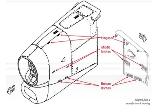

  • Where is the door on the picture ?
  • Nowhere..... I mentioned in the previous post the underside of the cowling. Simply go in the sim open the doors and go and look under the cowling aft of the intake
