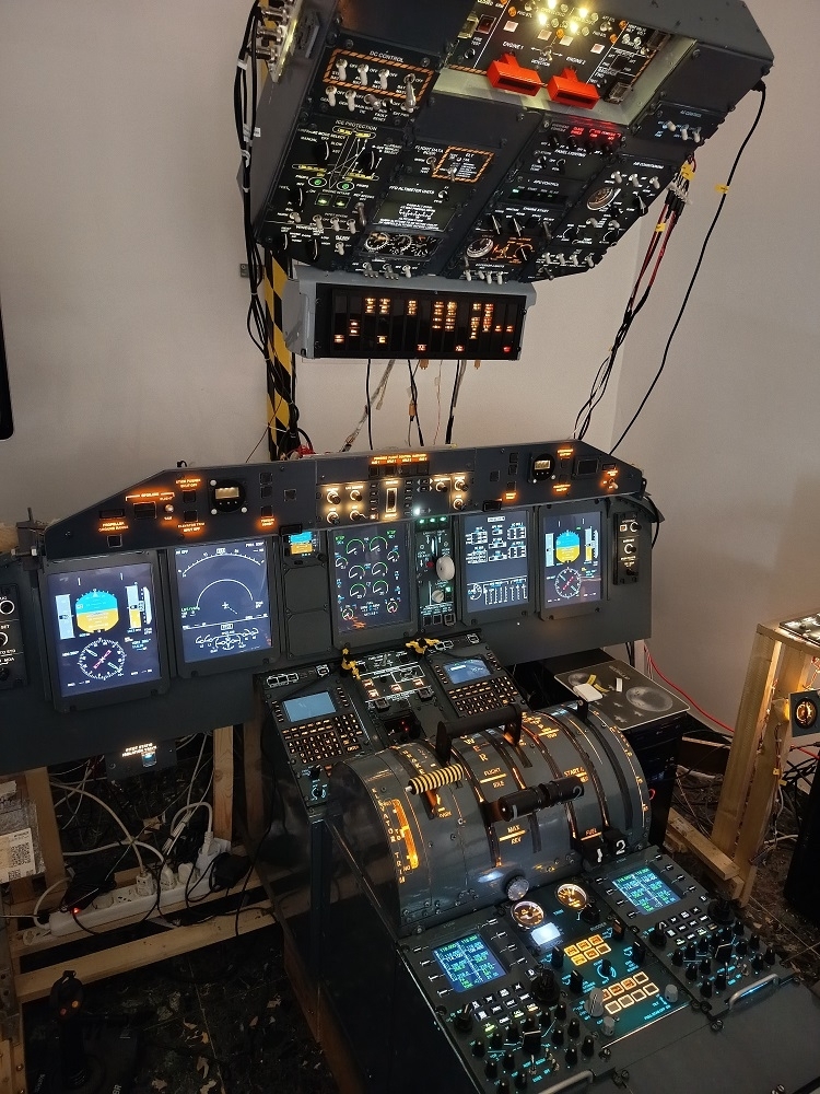

very generalized presentation of the PFDs and MFDs located behind the plasma cut aluminum front panel, without frames.
I think that the best and most real system will still be to buy 5 10.4 inch tablets (which correspond to the real size of the dash) and place them inside the frames, in practice it would be how the avionics are really assembled in the real plane.

yes i know kroswynd
but placing them behind the panel would be a too conspicuous step, in the real plane the monitors are mounted inside the frames of the panel and the residual thickness is minimal, if positioned behind the panel, with the frames in front the resulting step can somehow cover the first officer's view towards the captain and vice versa.
made to measure in hong kong in the end they did not cost very much, about 100 us dollars each and I think the result is better.
then I am a perfectionist, (and one of my great flaws I know)
the important thing as reported in the specifications of the home cockpit program, is that you can use more video outputs even if in the network, in the case of dash8 considering 3 video projectors for external graphics there are a total of 13.
I don't understand how the use of multiple monitors on the network works, but could you please explain it to me?

Hello everyone.
after a rest period I went back to work.
frontal panel finished, hydraulic control panel / GPWS landing flap and gear panel are missing.
(UDP 4 works great for transferring displays to other PCs, although I noticed that it creates a bit of a lag on the interface)
what do you think?

yes i know kroswynd

I would like to insert some photos of the new front panel but they are too big he tells me
Hello everyone.
what do you think?
Making great progress.
